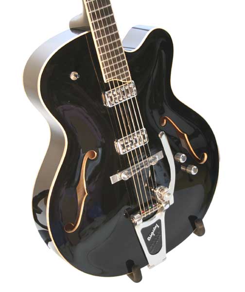

I just got back from a day trip to John Watkins' place. Since I was completely clueless on electronics, he was very instrumental (pun) in getting this one up and running. I'd have to say that hearing him play it in his crazy rock and roll style was quite cool.
A little about the guitar: Carved top and back just like a "real" archtop. Flamed maple binding. TV Jones pickups, bigsby tailpiece and rocker bridge. It was slated for black paint since the day I started designing it. Which was good because there was a little knot that uncovered itself on the back plate. This one is off to the Montreal show in a couple of weeks as the start of my RB (Rock-a-billy) line.

Ron, I realize it's pretty hard to get a scale but it's really nothing like a LP. 17" lower bout. the thing is HUGE. Modeled after the Gretsch Falcon line. This one is built exactly as an archtop with the exception that it has two small sets of struts for the pickups to screw into.
As for references: Benedetto is THE word on the subject. I studied both his book and video series (now that's a snoozer).

Wow, that is VERY cool Paul! I lusted for a good Gretch for years whan I played rockabilly, but I never did get one. Since I started making guitars I have been meaning to make one, I even traced and examined a nice 6120 closely a couple of years ago and made some drawings but that's it.
You say you built it like an archtop with 2 strus for the pickups... Could you elaborate, is it anything like the 6120 "trestle bracing"?
PostPosted: Tue Jun 20, 2006 9:18 pm
Arnt, I'm not familiar with teh trestle bracing. But these struts aren't really anything more than .75 x .75 pieces between the x and above the x running from neck to tail block. just something for the pickups to screw into.
The TV Jones pickups don't use a ring to support them. They just screw into whatever you have below them. And since there was nothing below them, I had to put something there.

Paul – looks quite excellent! I like the black gloss finish.
Whenever insomnia kicks if I just play a Benedetto video, I’ve yet to stay conscious and tend to get woken up when the VCR does the auto rewind
I gather the top is carved spruce? Did you bind the “f” holes as well with flamed maple?
Your bracing intrigues me, if I read your reply to Arnt correctly it sounds like you “X” braced it then have ?” x ?” parallel braces running from the neck to tail block? With all that bracing I am curious as to how it sounds acoustically. (Plugged in I’ll bet that baby wails with those TV Jones pick-ups).

Anthony, your tinking of the bracing is close. Think of it as you are but delete the parallel braces from the x to the tail block. So in other words, they are between the x braces and continue up to the neck block.
And yes the f holes are bound in flamed maple. YUCK!!!
